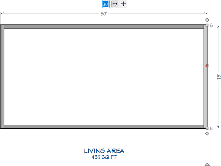

  2. Select a wall or other object in your Chief Architect/Home Designer program and click on the wall's controlling dimension line.
    Dimension input field for the length of a wall
  3. With the input field active, use your bluetooth laser measuring device and take a measurement.
  4. The bluetooth laser measuring device will transmit the data to the open dimension field and will automatically press Enter/Return to move the object to the new distance.
    If the dimension field does not close, press Enter/Return on your keyboard.
    Note: If you notice that the unit of measurement (", ') is not following the measurement value, enter this in using your keyboard and then select the Enter/Return key.
  5. Repeat the process until you are done measuring the rest of the structure.
