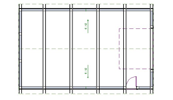

Once the defaults are set up, the structure can be drawn.

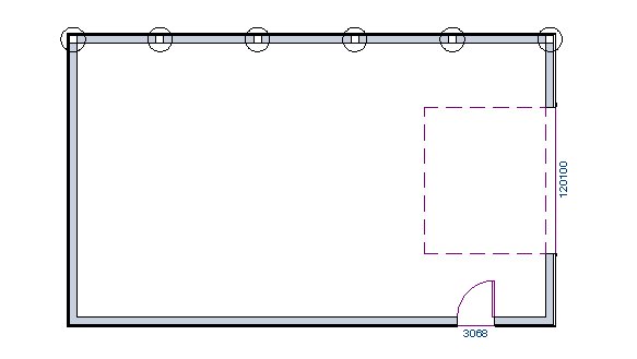

To draw the perimeter walls and place doors
- Select Build> Wall> Straight Exterior Wall , then click and drag to draw shape of the perimeter.
In this example, a simple 24' x 40' rectangular structure is used. Dimensions were previously set to locate the girts wall layer.
- Click in the room to select it, then click the Open Object edit button. In the Room Specification dialog:
- On the General panel, select Slab from the Room Type drop-down list.
- On the Structure panel, uncheck Flat Ceiling Over This Room.
- Select Build> Door> Hinged Door from the menu, then click on a wall to place a door. Starting in X11, barn doors can be added without using a library object by going to Build> Door> Barn Door .
Click on the door near the exterior edge, then use the Temporary Dimension to position it the desired distance from the corner.
In this example, a 3068 door is placed 4' 2" from the lower right interior corner.
- Select Build> Door> Garage Door from the menu, then click on the left wall to place a garage door at that location.
With the garage door still selected, click the Center Object edit button, then click inside the room to center the door along the wall.

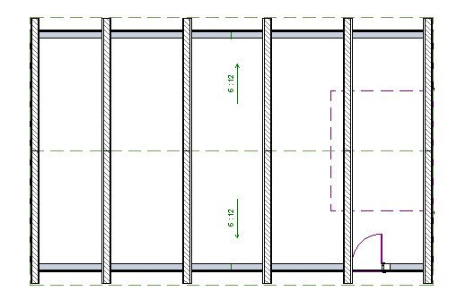

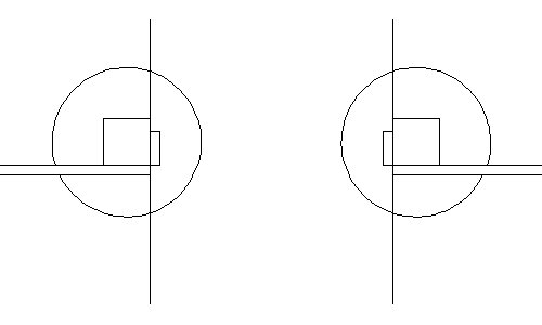

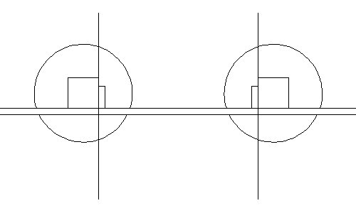

Zoom in on one of the corners on the right side of the structure, select Build> Framing> Post with Footing and click to place a post with a footing close to the intersection of the two walls.
- Hold Shift and click both the post and footing as a group selection, then use the Point to Point Move edit tool to position the post precisely in the corner of the 7 1/2" main wall layer.
This is easiest if Object Snaps are enabled - particularly Endpoint Snaps .
- With only the post selected, click the Open Object edit button. On the General panel of the Framing Specification (Post) dialog:
- Remove the check-mark from Raise/Lower.
- Click the radio button to Lock the Total Height, then specify the desired Top Height. In this example, the Top Height is 13' 2" (or 158"), which is 14" above the bottom chord of the roof trusses.
Lock the Top, then specify the desired Bottom Height. In this example, the Bottom Height is set at -48" so that it extends from the top of the floor, through the 4" slab and 44" into the footing.
- On the Line Style panel of the Framing Specification (Post) dialog box verify that the Layer is set to Framing, Posts.
- On the Fill Style panel of the Framing Specification (Post) dialog, Select Solid from the Fill Pattern drop-down list and set the Color to White.
- On the Materials panel you can create a green treated lumber material for the poles. In this example, we copied the material, CA-B Pressure Treated Lumber, and blended a green color with it.
- With the Select Objects tool, click on the footing to select it, then click the Open Object edit button. On the General panel of the Slab Specification dialog:
- Specify the desired Elevation at Top. In this example, -4" is used.
- Specify the desired Thickness. In this example, 48" is used.

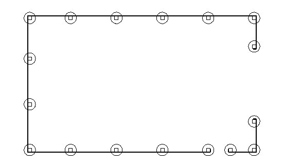

- Hold Shift and click to select the post and footing and click the Transform/Replicate Object edit button. In the Transform/Replicate Object dialog:
- Check the box beside Copy and specify 5 copies.
- Check the box beside Move and specify the X Delta value as -96". This will produce copies at 96" intervals to the left along the X axis.
- Click OK to close the dialog and make the specified copies of the post and footing.

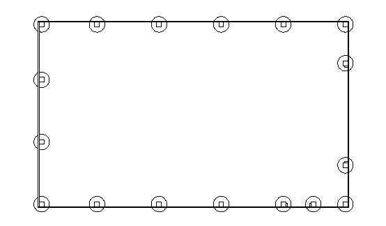

- Notice that the fifth copy of the post and footing are located beyond the structure. Use the Point to Point Move edit tool to position them at the nearest wall intersection, as in step 2, above.
- Repeat the steps above as needed to produce posts with footings around the perimeter of the structure.
Be sure to pull the post layout from the same end of the structure so that the roof trusses will align properly later.

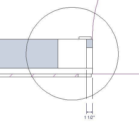

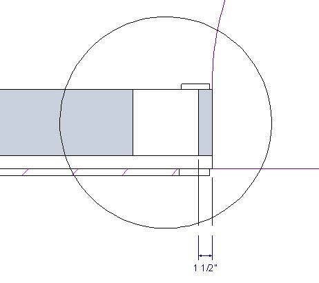

- Position posts on either side of the man door, leaving room for the 1 1/2" trimmers.
- To set their position, draw CAD Lines to serve as reference.
- Use the Copy/Paste and Point to Point Move edit tools to make a copy of a post and footing on each side of the door.
- Use the same process to places posts on either side of the garage door, leaving 3" for double trimmers.

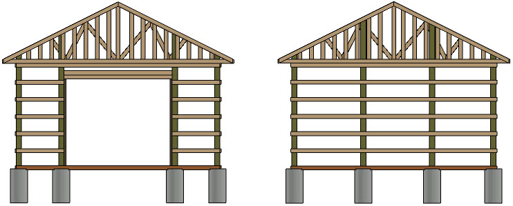

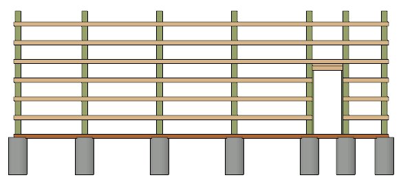

With the poles laid out, trimmers and headers for the doors can be added. Using the method described here, you can also build jamb furring if you wish.
To frame the doors
Zoom in on the man-door, then:

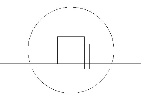

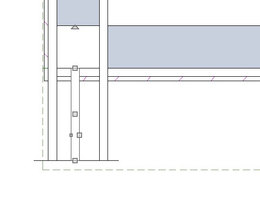

- Click on the post on the left-hand side of the door to select it.
- Create a copy of the selected pole directly to its left using any method that you choose.
- Click on the newly copied pole to select it, then click the Open Object edit button. On the General panel of the Framing Specification (Post) dialog:
- Change Width 1 to 5 1/2" and Width 2 to 1 1/2"
- Remove check-mark from Raise/Lower.
- Set the Bottom Height to 0" and then lock it.
- Change the Top Height so that it is equal to the door height plus its rough opening. In this example, a Top Height of 82" is used.
- On the Line Style panel, click Define button under the Layer heading and place the trimmer on a new custom layer, Framing, Door Trimmers.
- Click OK to close the dialog and apply your changes.
- With the post - now a trimmer - still selected, click the Point to Point Move edit button and move it to the outside edge of the nearest post, which is acting as the king stud.
- With the trimmer still selected, click the Copy/Paste edit button, then use the Reflect About Object edit tool to make a copy that lines up with the edge of the post on the other side of the door.

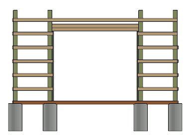

- Repeat the steps above to make trimmers for the garage door.
- To change the orientation of the trimmer, reverse its Width 1 and Width 2 values rather than rotate it.
- Specify a Top Height of 122".
- Make a copy of the first trimmer next to the original to create a double trimmer configuration.
- Hold Shift and select the two trimmers and use Copy/Paste and Reflect About Object to create the trimmers for the other side of the garage door.
- Select Build> Framing> General Framing from the menu, then draw a framing member between the two posts on either side of the garage door to create a header.
- Click on the header to select it and click the Open Object edit button. On the General panel of the Framing Specification (General Framing) dialog:
- Lock the Depth and set the Bottom Height to 122".
- Specify the Width as 3 1/2". This thickness is the equivalent of two 1 3/4" LVL members laminated.
- Click the Type drop-down list and select LVL.
- On the Line Style panel, click the Define button under the Layer heading and place the beam on a new custom layer: Framing, Headers.
- Click OK to close the dialog box and apply your changes.
- Once it is resized, use the Point to Point Move edit tool to position the header exactly along the exterior edge of the trimmers.
- Use the same process to create a header over the man-door.
- Although not required structurally, in this example the man-door header is also using LVL. The Depth is 11 7/8", the Bottom Height is 82", and the Width is 3 1/2".
- After the header piece is created, position it on the outermost edge of the trimmers with the Point to Point Move edit tool.

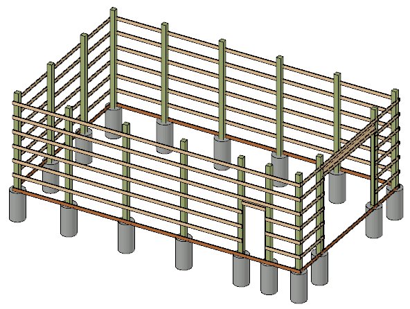

- Select 3D> Create Orthographic View> Framing Overview to see the results so far.

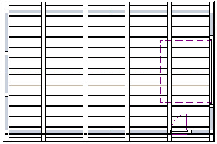

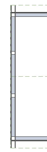

Once the poles and door framing is complete, girts can be added. The base girts can serve as the form for the concrete floor if you wish.
To create the door-level girts
- Return to floor plan view and select Tools> Layer Settings> Display Options from the menu to open the Layer Display Options dialog:
- Create a layer called Framing, 2 X 6 TRT Girt (Base).
- Create another layer called Framing, 2 X 6 FIR Girt.
- Turn off the display of the Framing, Headers and Walls, Normal layers.
- Lock the Footings, Post layer but leave it set to display.

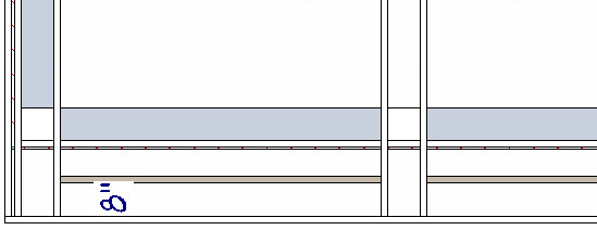

- Select Build> Framing> General Framing from the menu, then click and drag to draw a framing member along the length of each wall.
- Position these base girts so they are located just outside of the posts.
- The girt ends should line up so that they lap (or interlock) on the corners.
- Hold Shift and click to group-select the four girts and click the Open Object edit button. In the Framing Specification (General Framing) dialog:
- On the General panel, set the Depth to 5 1/2", then Lock the Depth and set the Top Height to 0".
- On the Line Style panel, place the girts on the new Framing, 2 X 6 TRT Girt (Base) layer.

To clip the girts at the doors
- In floor plan view, select CAD> Lines> Draw Line from the menu, then click and drag to draw CAD lines on either side of the man-door.
- Position the CAD lines where the girts should be cut to allow access through the door.
- In this example, the girts are clipped 1 1/2" from the door so a continuous vertical furring strip of that width can be applied to the trimmers.
- Hold Shift and select the two CAD lines, then click the Trim Objects edit button.
- Click and drag a cut line between the two CAD lines that crosses the girts.
- When you release the mouse button, the girts will be trimmed to the outside of the two CAD lines and the CAD lines can be deleted.
- Repeat these steps to cut the girts around the garage door.
Additional girts can now be added to reach the top of the 12' high walls.
To add girts above the door levels
- Select Edit> Default Settings from the menu and open the Layer Set Defaults dialog.
- Click the Backclipped Sections drop-down and select 3D Framing Set from the list.
- Click the Define button to the right of the Backclipped Sections drop-down and in the Layer Display Options dialog, turn on the Framing, 2 X 6 TRT Girt (Base) and Framing, 2 X 6 FIR Girt layers in this layer set.
- Click OK to return to the Layer Set Defaults dialog, then click OK to close it, and then click Done in the Default Settings dialog.
- Create a Backclipped Cross Section of the exterior of the man-door wall.
- Notice that the 3D Framing Set is active instead of the usual Section View Set layer set.
- Select the top-most girt on the right side of the man-door.
- Click the Open Object button and change the Bottom Height to 82" and click OK.
- Use the edit handles to move the girt to the left, in front of the header. Then resize it to fit between the posts.
- Select the top-most girt on the left side of the wall and use its edit handles to extend it to the outside of the corner pole on the right.
If you have trouble precisely placing the Girts, turn off the Snap Grid and then use the Point to Point move tool.
- With the top girt still selected, use the Transform/Replicate Object tool to create two more copies in the Z delta at 24" intervals.
- Close this view and then create a new Backclipped Cross Section camera arrow through the garage door wall from exterior to interior.
- Hold Shift and select the two highest girts on each side of the door and use the Transform/Replicate Object edit tool to create two copies at 24" intervals in the Z delta.
- Select one of the highest girts and click the Open Object edit button to set the Bottom Height to 122".
- Use the edit handles to move the girt in front of the door header, and resize it to fit between the posts.
- Select the remaining highest girt and use its edit handles to extend it to the outside of the opposite corner pole.
- Close this view and create an Orthographic Framing Overview .
- Hold Shift and select the highest girts in each of the two walls that do not have doors.
- Use the Transform/Replicate Object edit tool to create two copies at 24" intervals in the Z Delta.
As part of the process of drawing the girts, the horizontal door furring has been created. Vertical furring should also be added.
To finish the door furring
- Return to floor plan view and select one of the man-door trimmers.
- Use the Transform/Replicate Object edit tool to create one copy directly in front of the original - in this example, -1 1/2" in the Y Delta.
- Use this new furring strip's edit edit handles resize it and create a 1 1/2" X 1 1/2" vertical furring strip in the girt layer of the wall.
- Use the Copy/Paste and Point to Point Move edit tools to create the furring strip on the other side of the door.
- Select one of the garage door trimmers and repeat the process described above, replicating the trimmer along the X Delta rather than the Y.

To create the roof trusses
- Select Build> Framing> Roof Truss from the menu, then click and drag to draw a roof truss near the gable wall opposite the garage door wall.
- Click on the roof truss to select it, then use the Move edit handle to position it against the poles within the left gable wall.
- With the truss selected, use the Transform/Replicate Object edit tool to make one copy -9" in the X Delta, which will put it on the outer edge of the posts, above the girts.
- 9" is the total thickness of the posts (7 1/2") plus the thickness of the truss (1 1/2").
- If your outer truss does not sit above the girts, it is likely that your custom wall type does not have its girts layer set as the Main Layer.
- Hold Shift and select the two trusses, then use the Copy/Paste and Point to Point Move edit tools to create identical copies on the opposite end of the structure.
- With the two newly created trusses still selected, use the Transform/Replicate Object edit tool to create four copies at -96" intervals in the X Delta.
- Select the outermost truss on the left-hand side of the building and click the Open Object edit button. On the General panel of the Roof Truss Specification dialog:
- Check the box beside End Truss.
- Check the box beside Force Truss Rebuild.
- Click OK to close the dialog and implement the change.
- Select the outermost truss on the right-hand side of the building and use the same steps to convert it to a Gable End Truss.

To draw the purlins
- Select Build> Framing> Roof Blocking from the menu.
- Click and drag to draw a Roof Blocking member between the pair of trusses over the back gable wall and the pair of trusses over the garage door wall.
- Position the Roof Blocking, or purlin, in the overhang area of the trusses.
- Select the purlin and click the Open Object edit button.
- On the Line Style panel, click the Define button under the Layer heading and:
- Turn off the display of the Framing, Roof Blocking layer.
- Create a new layer called Framing, Roof Purlins select it and click OK to place the purlins on this layer.
- On the Fill Style panel:
- Select Solid from the Fill Pattern drop-down list.
- Select a pale brown Fill Color.
- Click OK to exit the dialog saving the changes.
- Position the purlin 8" inside the Eave Sub Fascia.
- Use the Multiple Copy edit tool to make six copies of the purlin in the direction of the roof ridge. Note that the default Multiple Copy Interval is 24" for Rafters.
- Repeat these steps to create purlins on the opposite side of the roof.
