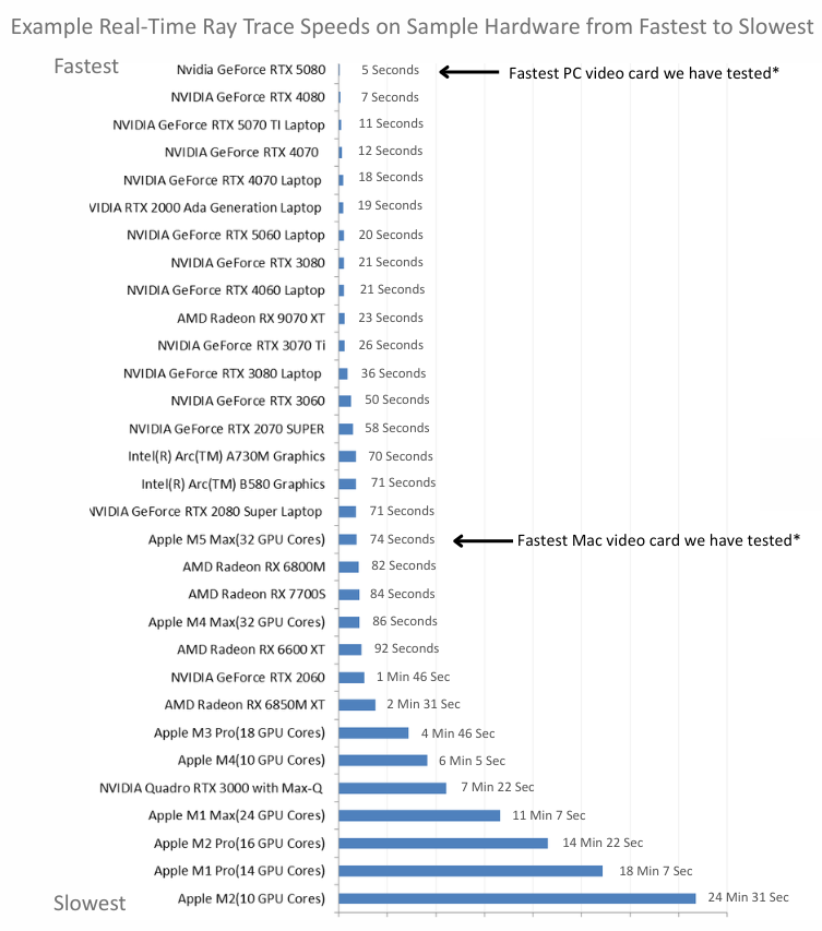

Real-Time Ray Tracing (PC and Mac)
Ray Tracing creates photo-realistic views by simulating light as it moves through a model and bounces off of surfaces. Older versions of Chief Architect performed traditional CPU ray tracing, which can be time-consuming, sometimes hours, depending on your computer hardware and model size. Newer versions of Chief Architect perform real-time ray tracing using the GPU, producing realistic views in seconds with the Physically Based (Ray Trace) technique. Real-time ray tracing in Chief Architect was introduced for Windows in Version X13 and for Mac in version X16.
Real-time ray tracing uses a technology called hardware acceleration, which means the video card has physical circuitry dedicated to tracing rays in a 3D scene. API’s available from computer and video card manufacturers allow developers to integrate real-time ray tracing using hardware acceleration into their applications. For Windows PC’s, real-time ray tracing using hardware acceleration and APIs has been available since at least 2018. On Apple computers, real-time ray tracing using hardware acceleration and APIs has been available since 2023. This five-year difference in the availability of real-time ray tracing using hardware acceleration and APIs has resulted in superior technology and faster performance on Windows PC’s.
Mac computers perform real-time ray tracing, however being a newer technology to the Mac platform the real-time ray tracing speed is slower than Windows PCs. That is not to dissuade you from getting a Mac if you prefer Apple computers. Macs with an M-series chip can render photo-realistic views in seconds-to-minutes performing real-time ray tracing utilizing your computer’s video card versus minutes-to-hours performing traditional ray tracing utilizing your computer’s CPU. If you are going to be computer shopping for a Mac and you are going to be doing a lot of photorealistic 3D rendering, you should choose a Mac with an M5 Max 32-core GPU or better.
*While we can’t test every GPU out there, we expect Nvidia’s RTX 5090 to outperform the 5080 on PC.
Approximate time in testing to render 500 samples at 1400 x 860 in Chief Architect Premier X17 using the “Nashville Kitchen” sample plan. Actual results may vary.
